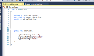

Step-1 Create a class SLD_DemoClass.
Step-2 Declare 3 variable like below and one public method to set value in these variable.

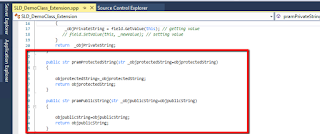

Step-5 To Access private attribute in class extension, We need to use C# reflection library.
Step-6 Now write the below code to access private attribute on run-time.
following is the screenshot of the complete code of extension class.
