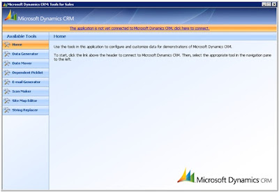

Launch the MSDYCRM4.0_Demonstration Tools.exe
Use the Site Map Editor to modify the contents of the Microsoft Dynamics CRM Navigation Pane. You can use the editor to move, add, or delete items from the navigation pane.
NOTE: It’s strongly recommended that you back up your CRM data before using this tool.

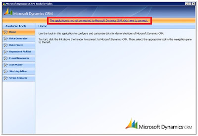

• Select the hyperlink “The application is not yet connected to Microsoft Dynamics CRM, Click here to connect”. Located on the top of the page as shown below .

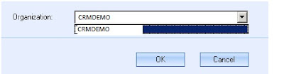

• Select the correct Organization from the dropdown
