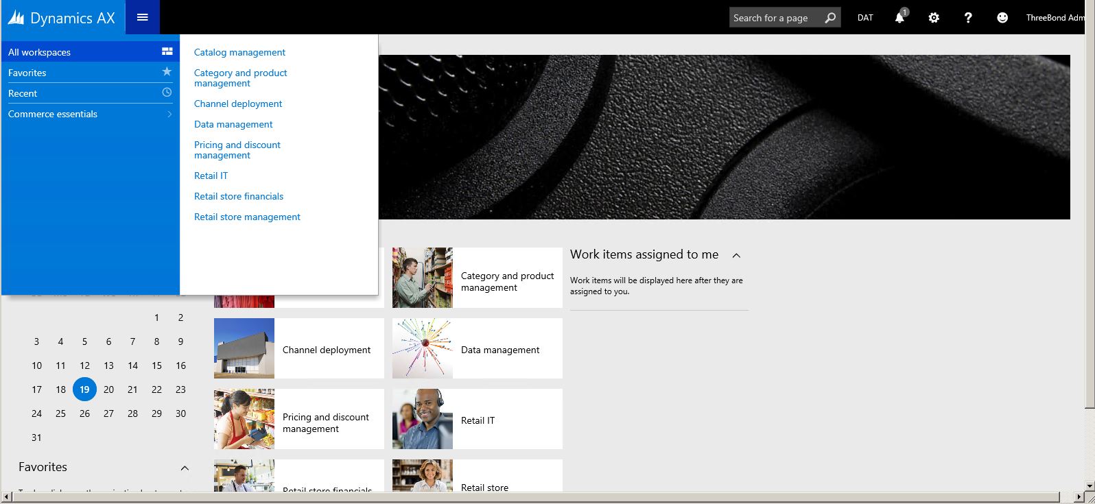

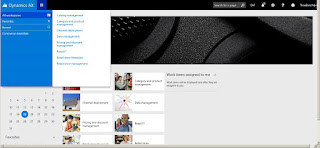

[COLOR=rgba(0, 0, 0, 0.701961)]Recently we faced an issue while implementing AX 7 for one of our customer. The issue was with the menu Items displayed on the left hand side of the browser. We simply couldn't see the menu even though we logged in using the System administrator account. All it displayed was few menu's hiding the rest. Please refer to the image below for more clarity.[/COLOR]

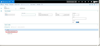

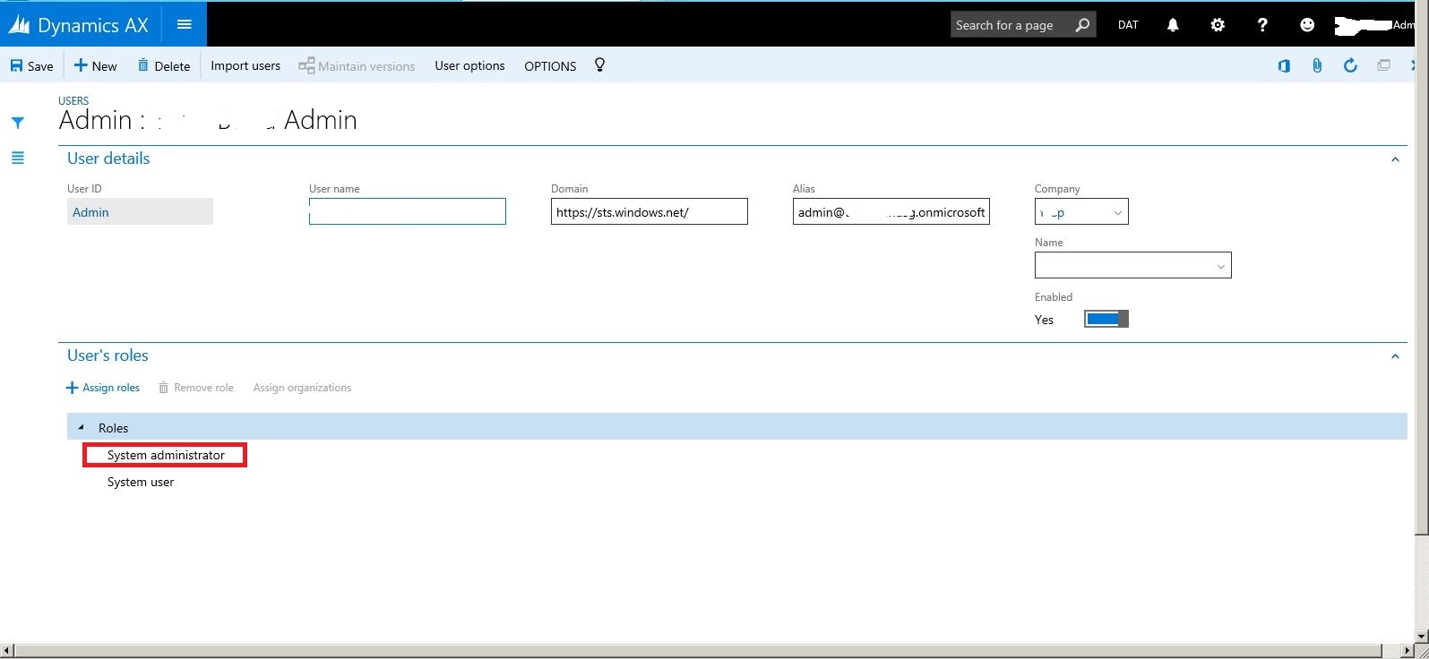

[COLOR=rgba(0, 0, 0, 0.701961)]Logged in using the system administrator account[/COLOR]
[COLOR=rgba(0, 0, 0, 0.701961)]After doing lot of re-search we figured out that the issue is caused because Commerce essentials configuration in the license configuration for AX 7 was enabled due to this the system will only enable basic functionalities related to Retail and hence the menu was not being displayed.[/COLOR]
