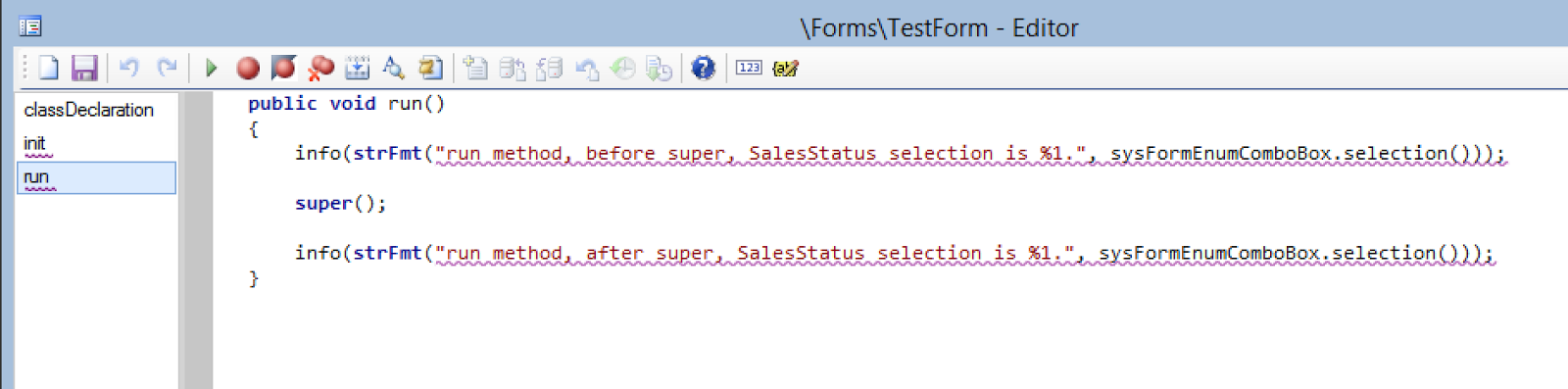

In form run method selection method is called before and after super():
The results are:
init method, after super, SalesStatus selection is 255.
run method, before super, SalesStatus selection is 255.
run method, after super, SalesStatus selection is 3.

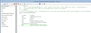

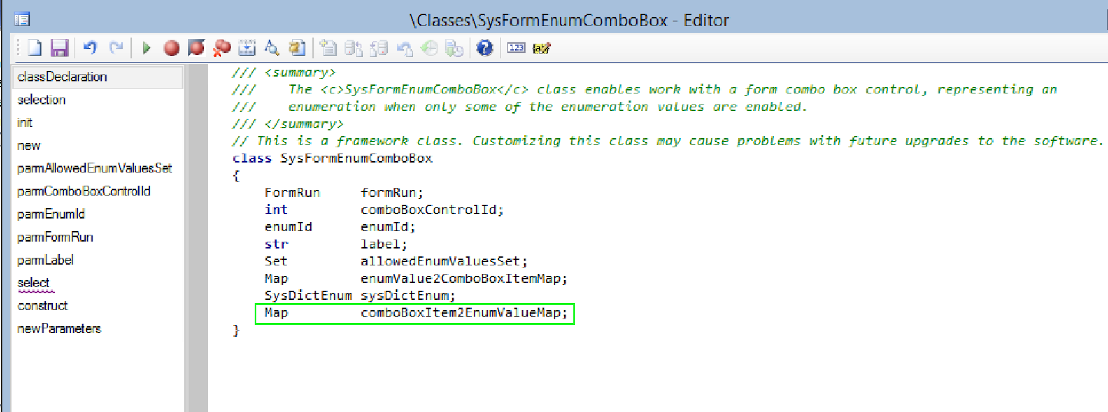

1. Add a new map comboBoxItem2EnumValueMap to classDeclaration:

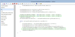

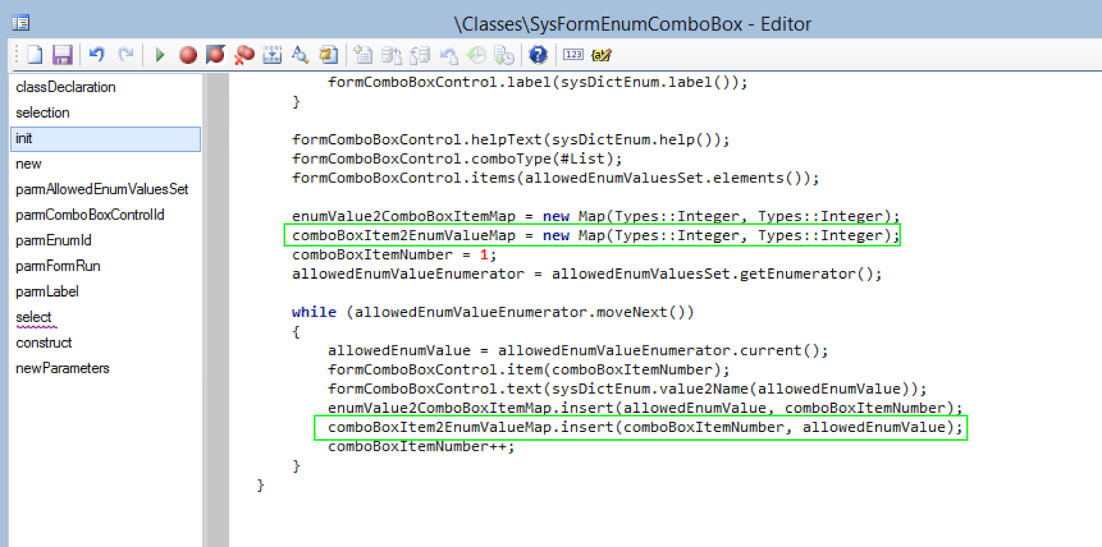

2. Initialise and fill map in init method:

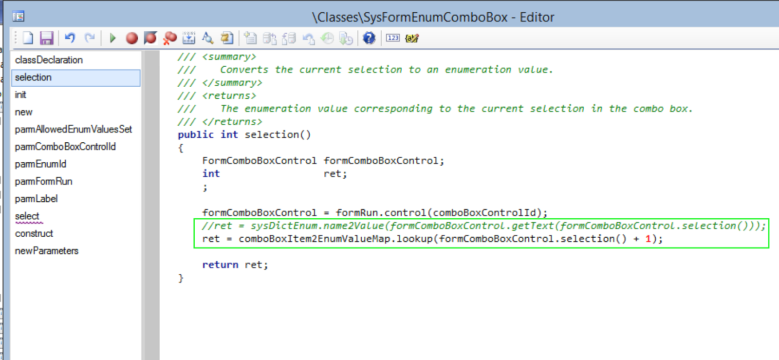

3. Use map in selection method:
The results are:
init method, after super, SalesStatus selection is 3.
run method, before super, SalesStatus selection is 3.
