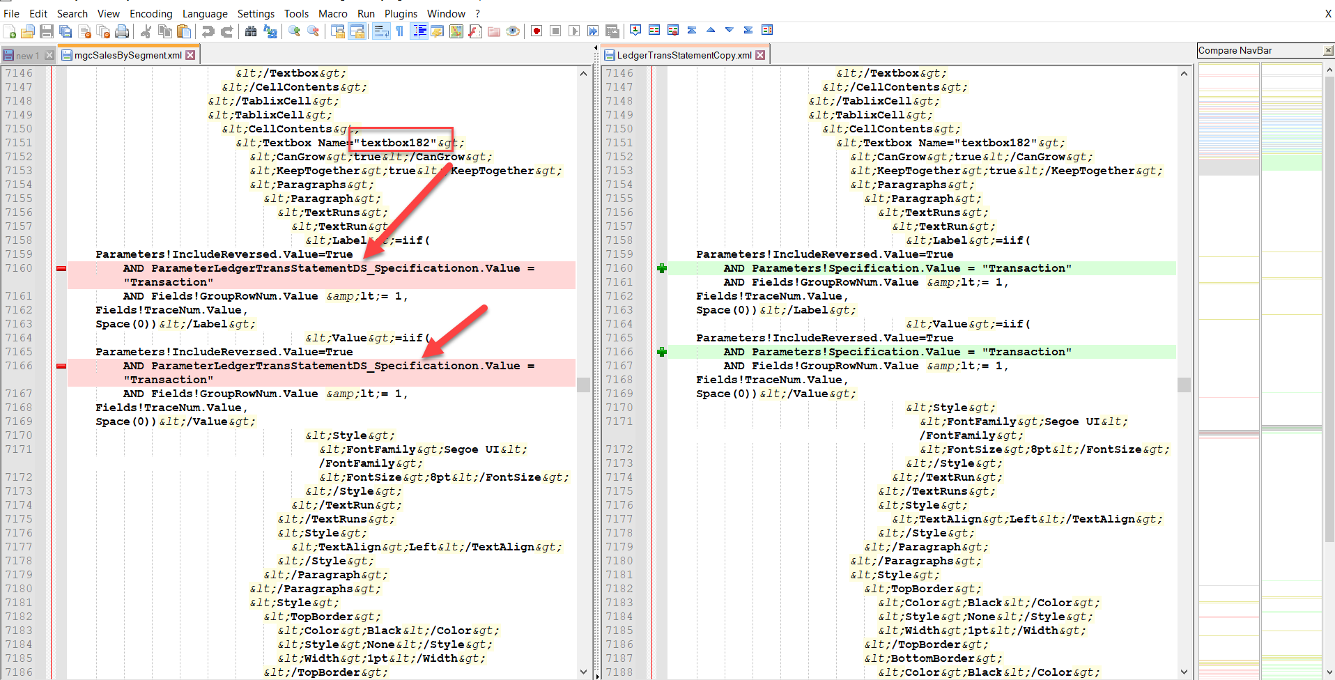

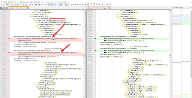

Fortunately there is a some workaround. You can open XML files for both of the original report and your copy of it in Notepad++ and run Compare over them (Install this Compare plugin).
Then scroll down to the first bad guy: a couple of strings above you will see its name.

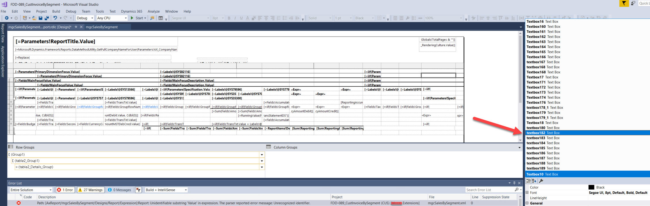

Go back to the editor, find this textbox.
Now check its corrupted property function expressions and fix it.
