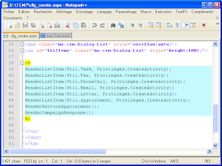

Removing an activity in the "New" activity dialog in activities grid
To remove the activity you want, open the file \Activities\dlg_create.aspx.
Search for the block in blue in the screenshot below. You can comment or delete the lines that correspond to the activities you need to hide. Then save the file.

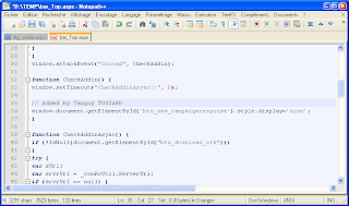

Removing an activity from the "New activity" top menu
For this one, open the file \_root\bar_top.aspx.
Search for the function "CheckAddin()". This method is called during page loading. Add the line (see screenshot below) corresponding to the activity you need to hide.
The all list of activities id is:
  • btn_new_task
  • btn_new_fax
  • btn_new_phonecall
  • btn_new_email
  • btn_new_letter
  • btn_new_appointment
  • btn_new_serviceappointment
  • btn_new_campaignresponse
The result, if I hide the camaping response activity is below:
