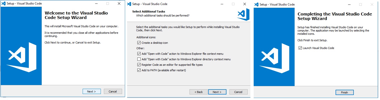

Install the Visual Studio Code as shown below. (Run as administrator)
