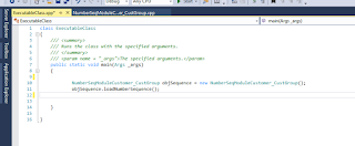

Create a new class with name NumberSeqModuleCustomer_CustGroup that extends the NumberSeqModuleCustomerclass and then create the method loadNumberSequence.
Reference Screenshot:

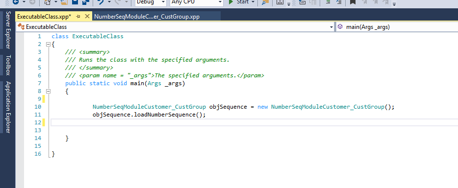

Now create Run able class to initialize the number sequence...

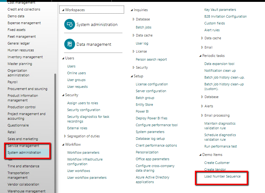

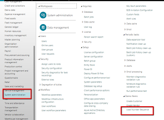

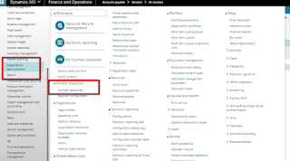

Perform build & Sync and load the number sequence. In my demo i have place Action menu item of executable class on following navigation.

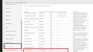

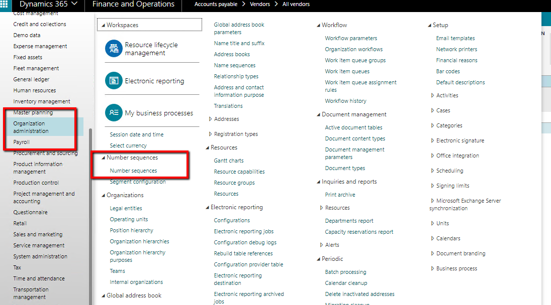

Now Navigate to organization administration > Number sequence and generate number sequence.

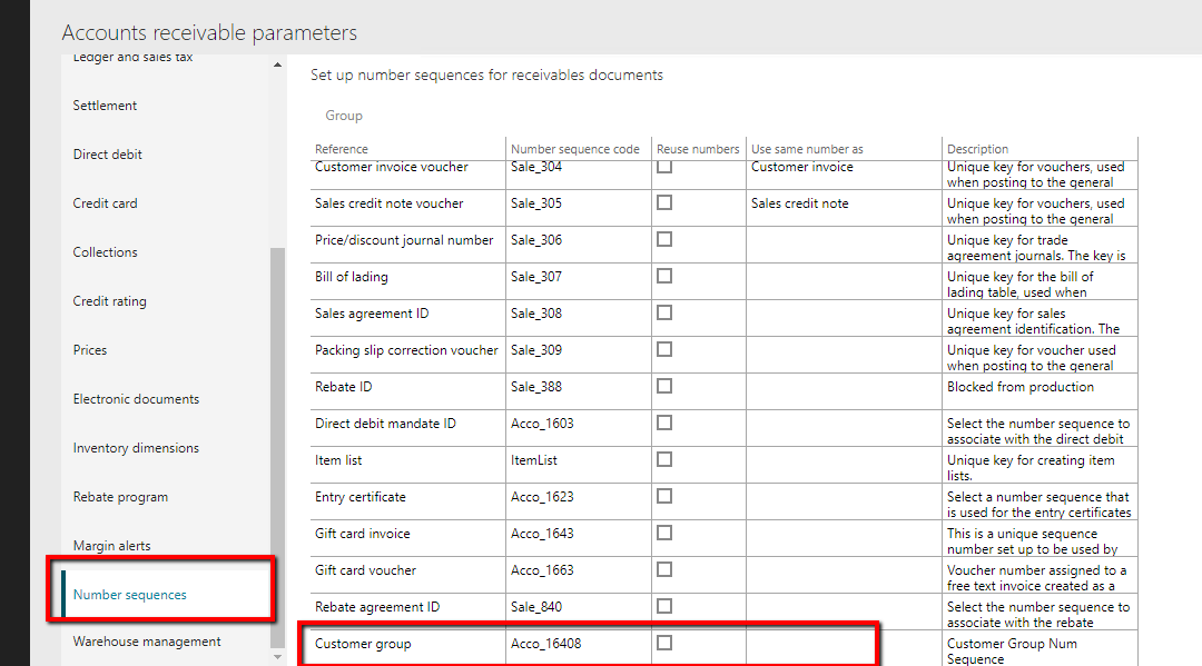

Next Step to Navigate to Account receivable parameter setup to veriy our newly create number sequence loaded successfully or not... You have to verify on your desire number sequence module.

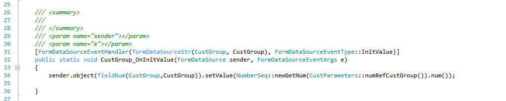

Next step to override CustGroup form data source Initial value event.
Perform build & Sync and verify on your cust group.. for me its working fine please have look on below screenshot.
