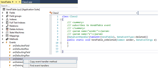

Cool isn’t it? But what if you need to change behavior? Some eventing capabilities existed in AX 2012 but anyway you had to modify the initial object anyway in order to subscribe an event handler to its event.
In AX7, you may subscribe to pre-, post- events, system-predefined object events or developer-defined class delegates in declarative way, without changing the source object. Just decorate an event handler method with attributes defining the event. Event handler must be in the same or in a referenced package. And that is quite impressive, I need to say.
The downsides of such approach are also known:
  • Poor code readability - you never know what is executed before or after your code. If you finish your method with “return 1;” it does not mean it will return one. There may be an unlimited number of post-handlers willing to override your and each other’s return values with unpredictable result.
  • Not guaranteed sequenced of handler's’ execution.
  • Cumbersome way of parsing and casting formal parameters and returning result at runtime. You have to use special vehicles to pass and receive them. And error-prone, too.
  • Does not support all scenarios. You cannot not intrude into an arbitrary place of a method if there is no delegate.
Microsoft promises to increase the number of extension types and events so they can support most of the typical modifications. The currently supported may be found here:

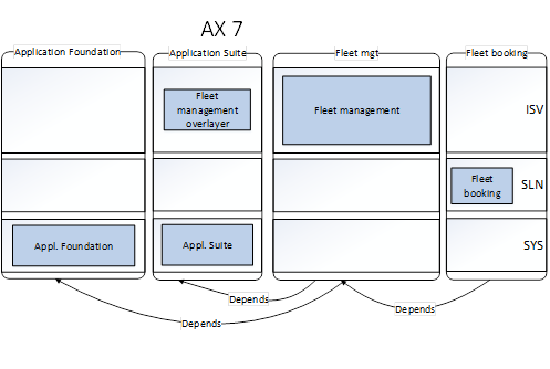

Overlayering
Old good overlayering still exists, but in fact may be done only within one package and may eventually be abolished by Microsoft, meaning that once you’ll get a set of standard objects and events that you can extend or hook up to but never change or even see the source code.
That in fact means that layers only matter within one package. Let’s say you’re developing you own Fleet management application that overlayers and uses some standard code and also introduces new objects. Fleet booking in its turn is a customer-developed add-on to Fleet management. In AX 2012 you would create new models at proper layers.
In AX 7 you’ll probably face a tough choice. The recommended, way of development is to create your own package and not to modify any standard code but only extend and subscribe to its events. However, because the present extension mechanisms do not cover 100% of your modification scenarios you’ll probably have to have an overlayering part (e.g. in Application suite). And this overlayering part won’t be able to use any code from your main model, because the reference is already set in opposite direction (your package –> Appl. suite). Say, you cannot modify a lookup on SalesTable form and call your class from there.
One of possible solutions is to overlayer the standard objects, but keep the footprint of your changes as small as possible through e.g. declaring a delegate in the overlayered code.
Imagine you develop a Fleet management application in a separate package and you have to modify Application suite and Ledger logic but extensions do not support your scenarios. If you want to reuse e.g. an EDT like FMCustTable in all modifications, the structure of your application will have to evolve as follows:
Meaning you’ll have to spin-off some common code into a separate package for common use.

У меня мысль такая.
По идее надо различать API и детали реализации, API это то, изменения чего можно хоть как-то контроллировать (т.е. разделять ломающие изменения и не ломающие).
Если выставлять все методы в API проще плюнуть и париться с ломающими изменениями. Т.е. объявление метода protected должно быть неким ответственным шагом.
С другой стороны, если потребитель принял решение поменять метод с private на protected, это вполне его право - он знает, что берет решение о поддержке этого куска на себя.
Сейчас пока не все готово для того, чтобы полностью отделить API от деталей реализации (Например нет InternalsVisibleTo что делает невозможным юниттестинг), но как-мне кажется, направление в уелом правильное - разделить поддерживаемые и неподдерживаемые модификации.
