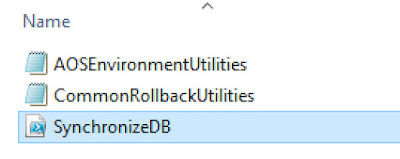

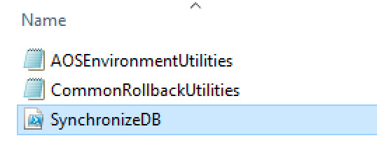

Notice that I have imported some modules, and you may be wondering where I got those. These PowerShell modules are part of the Software Deployable Packages, and either you can create one yourself, or simply download one of those made available by Microsoft in LCS. Extract the package and look under the following path, \AOSService\Scripts. Just grab the two files and make sure you save them alongside your script, like the example below:
