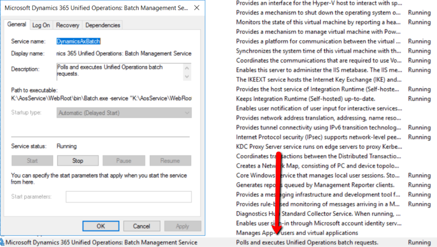

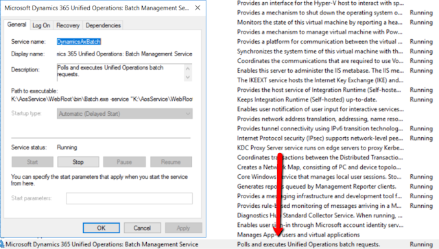

I stopped DynamicsAxBatch, which execute actual batch processing in D365.

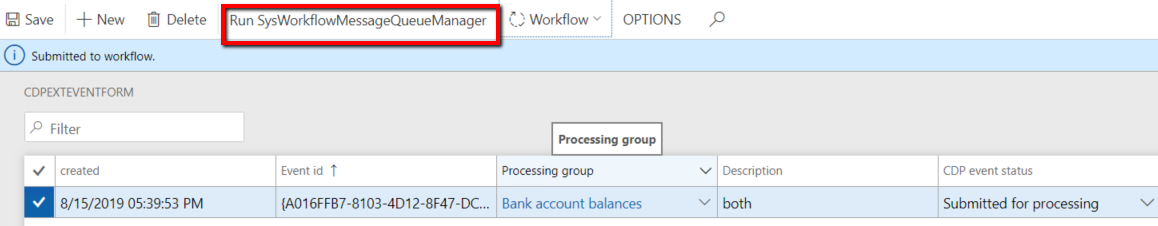

I added the following simple class and and a menu item button to a form.
class CDPWFDebuggerActive
static public void main(Args _args)
SysWorkflowMessageQueueManager::runStatic(conNull());
Now I run it by the button to execute batch processing in step-by-step mode, and it perfectly hits my breakpoints inside of Workflow handlers once I attached to the standard IIS process.
