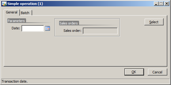

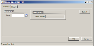

RunBase framework is used when we develop a class to run an operation within Dynamics AX, such as posting a sales order or used in any data manipulation operation. If we need to batch the operation, we will commonly use the RunBaseBatch framework by extending the RunBaseBatch class.
Dialog for a class that extends RunBaseBatch

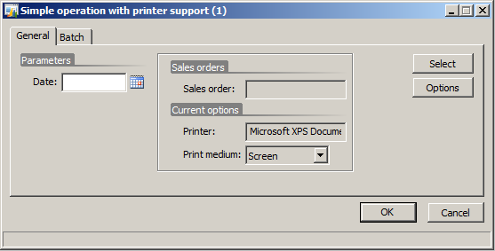

The RunBaseBatch class does not provide the access to printer such as when running a report. If you need to provide the printer support to allow users to specify the printer options in the operation, you can extend the RunBaseBatchPrintable class instead of RunBasebatch class.
Dialog for a class that extends RunBaseBatchPrintable
