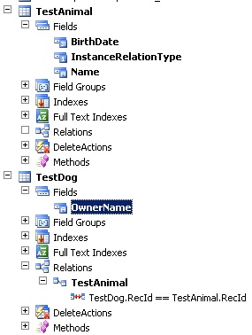

For example, there are 2 tables (TestDog extends TestAnimal):

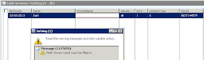

Let's make TestDog.OwnerName field mandatory and create a record in TestDog with blank OwnerName:
A warning is shown, which is correct. Now let's close the form. Normally, you would expect a dialog "Changes have been made in the form. Save changes? Yes/No". But in our case, the records are saved in both tables, with a blank mandatory field in TestDog.
