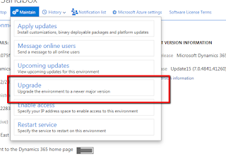

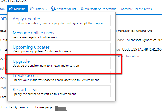

Step-1 Navigate to your required Environment and click on maintain.

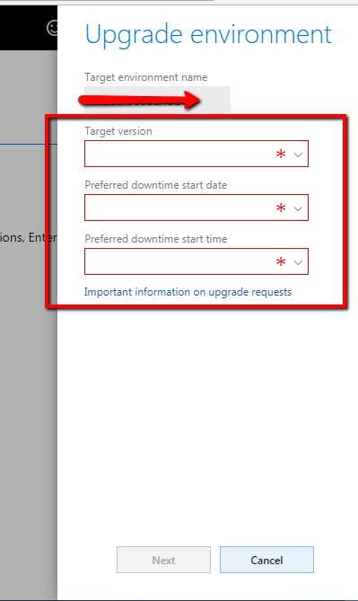

Step-2 Now click on upgrade a popup window will appear.

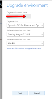

Step-3 Popup window contains 3 fields to be filled.
  1. Target Environment
  2. Preferred downtime start date
  3. Preferred downtime start time
Select the Build release on which you want to upgrade your environment and provide downtime as per your feasibility then click next.
Following is the filled screen shot for your reference.

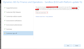

Step-9 verify the summary
Step-10 Now enter your Account name in the text box and click save.
Service will submit to Microsoft and they will start working on the given time window.
